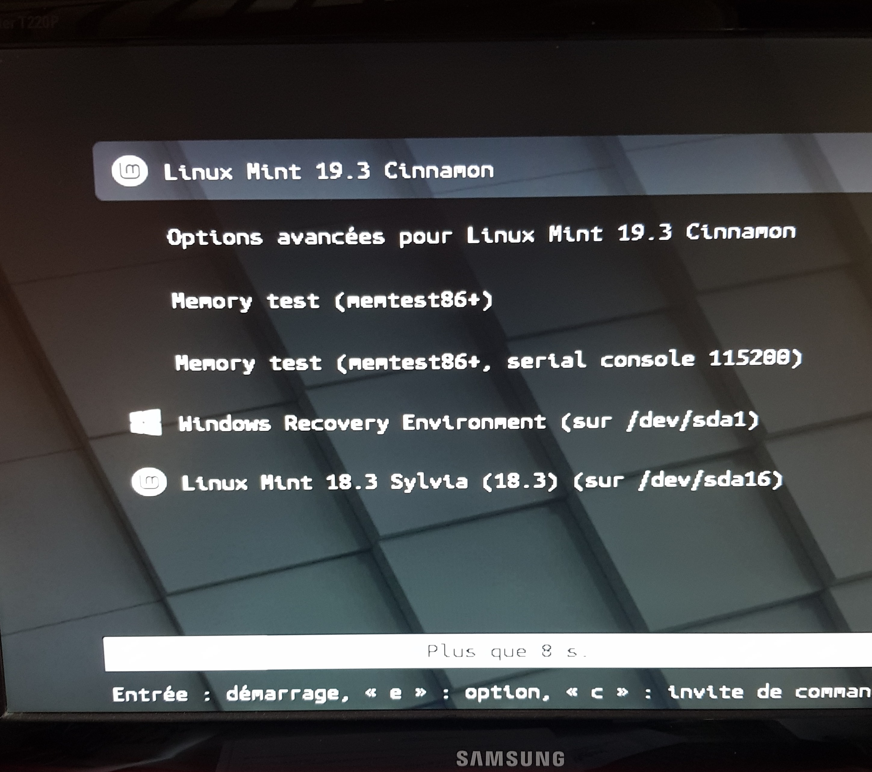

Je rencontre des pob avec Grub qui ne m'affiche pas toutes les entry.
Après Mint18.3 plus rien! Je patauge...
Merci d'avance.
fanch@fanch-Aspire-X1930:~$ grep ^menu /boot/grub/grub.cfg
menuentry 'Linux Mint 19.3 Cinnamon' --class linuxmint --class gnu-linux --class gnu --class os $menuentry_id_option 'gnulinux-simple-d20182b6-259b-44e9-abe7-2ee0ca6c4485' {
menuentry 'Memory test (memtest86+)' {
menuentry 'Memory test (memtest86+, serial console 115200)' {
menuentry 'Windows Recovery Environment (sur /dev/sda1)' --class windows --class os $menuentry_id_option 'osprober-chain-BA12A9E712A9A8B9' {
menuentry 'Linux Mint 18.3 Sylvia (18.3) (sur /dev/sda16)' --class linuxmint --class gnu-linux --class gnu --class os $menuentry_id_option 'osprober-gnulinux-simple-70d1d26e-541e-45c1-9ecb-142538696e25' {
menuentry 'Windows 10 (sur /dev/sda2)' --class windows --class os $menuentry_id_option 'osprober-chain-4E76AA3C76AA24A5' {
menuentry 'Windows 7 (sur /dev/sda3)' --class windows --class os $menuentry_id_option 'osprober-chain-722AAB6D2AAB2CD3' {
menuentry 'Ubuntu 12.04.2 LTS (12.04) (sur /dev/sda5)' --class ubuntu --class gnu-linux --class gnu --class os $menuentry_id_option 'osprober-gnulinux-simple-598d3525-3aac-4d7e-b51a-d16252cb2112' {
menuentry "...       clonezilla-live-2.2.2-37-amd64" {
menuentry 'ISO Ununtu 14.04 64bits' {
menuentry 'Mint19.3 64bits' {
Ci-dessous photo du menu

fanch@fanch-Aspire-X1930:~$ df -k
Sys. de fichiers blocs de 1K   Utilisé Disponible Uti% Monté sur
udev                 1968904         0    1968904   0% /dev
tmpfs                 401232      2828     398404   1% /run
/dev/sda17         102685624  12610780   84815684  13% /
tmpfs                2006144    281460    1724684  15% /dev/shm
tmpfs                   5120         4       5116   1% /run/lock
tmpfs                2006144         0    2006144   0% /sys/fs/cgroup
/dev/sda18         102685540  21760112   75666272  23% /home
tmpfs                 401228        68     401160   1% /run/user/1000
/dev/sdb1          117716284  44881636   66811944  41% /media/fanch/aa1b3641-7c25-4c87-9b95-7c4afadfbb44
/dev/sdc1          976760000 497452440  479307560  51% /media/fanch/MEMUP-1Go
fanch@fanch-Aspire-X1930:~$ sudo grub-install /dev/sda17
[sudo] Mot de passe de fanch :
Installation pour la plate-forme i386-pc.
grub-install : attention : Le système de fichiers « ext2 » ne prend pas en charge l'embarquage.
grub-install : attention : L'embarquage est impossible. GRUB ne peut être installé sur cette configuration qu'en utilisant les listes de blocs. Cependant, les listes de blocs ne sont PAS fiables et leur utilisation est déconseillée..
grub-install : erreur : refus de continuer avec les listes de blocs.
Je ne comprend pas la partition sda17 qui boote en Mint 19.3 est en ext4.
Desktop : Acer Aspire X1930 / tri-boot : Linux Mint 20 &Linux Mint 18.3 & W10 & Ubuntu 13.10
Distribution : Linux Mint 19.3 Cinnamon 64-bit 4.4.7 CPU : 3,30 gigahertz Intel Core i3-2120 / ram : 4Go
[Hard drive] :WDC WD10EARX-22N0YB0 (1000,20 GB) / [Display adapter] :NVIDIA GeForce 605 /Kernel Linux : 4.4.0-146-generic / :geek:
fanchTelecom
Messages : 24
Enregistré le : ven. 23 sept. 2016 17:27
Localisation : Bretagne Pays Bigouden
Re: Grub n'affiche pas toutes les entry
Message par fanchTelecom »
J'avais fait une erreur
Installation terminée, sans erreur.

Désolé ça n'a rien changé.
